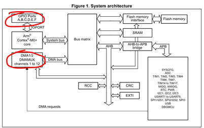

2026-03-13 6:09 AM - edited 2026-03-13 6:10 AM
This can't be done. The GPIO ports are not accessible to the DMA on the STM32G0x0.

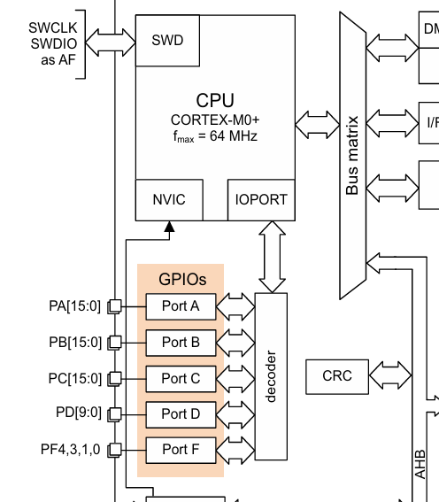

2026-03-13 6:10 AM - edited 2026-03-13 6:11 AM
Do you know where this can be found in the datasheet / reference manual, so that I can check whether other CPUs support this?
2026-03-13 6:13 AM
Search for "system architecture" in the Reference Manual.
2026-03-13 6:14 AM
I misread this as being connected to AHB 🤦
