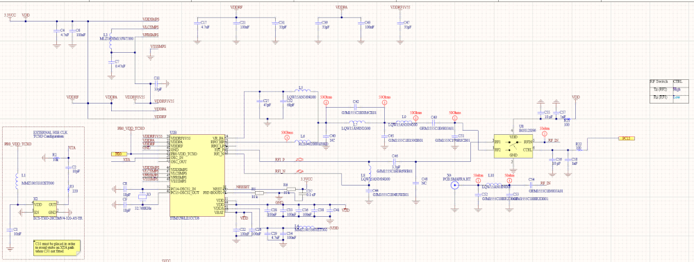

I create a custom board from the reference MB1791.
But when I try to run an example for the Lora SubGhz module - it doesn't work, no interrupt, no transmit to the antenna (watch in SDR).
I ran this example code with RAK3172 (also a custom board) and this code works.
Voltage V 1.5 = 1.5V on the board
I try to run without TXCO, but RAK3172 also doesn't have TXCO

}I have checked the pin for the RF multiplexor, and it works
Please help me, what can I check on my board and in code?
2023-06-10 7:11 AM
The problem was with TXCO 32 mhz
