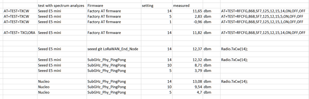

i found the error, it was the clock domain for the one gpio pin that was not right, so the one gpio did not work .. :)
my measurements if anyone could be interested ..
0693W00000NrJXWQA3.pngNucleo is a littel bit better.

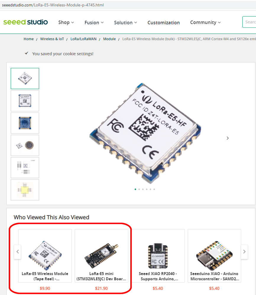

What, exactly, do you mean by, "seeed LoRa-E5" - a board? a module?
0693W00000NqYZGQA3.pnghttps://www.seeedstudio.com/LoRa-E5-Wireless-Module-p-4745.html
