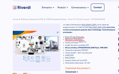

Hello @Kannika and welcome to the ST community;
AN4861 "Introduction to LCD-TFT display controller (LTDC) for STM32 MCUs"
https://www.st.com/en/partner-products-and-services/riverdi-stm32-displays.html
Using Riverdi board:
https://riverdi.com/fr/product/7-inch-lcd-display-stm32h7-frame-rvt70hssfwn00?srsltid=AfmBOor6JTenPNM1U1ScMpNVHtrKVtVqVj-XNgeCxwg_m1t2NYd8tHEm
So yes it can interface 7" 1024×600 LCD with STM32H743ZI.
PS1: STM32H755 have the same LCD-TFT peripheral.
PS2: STM32H743ZI is a 144 package check if all LTDC signals are available on that package.

Riverdi (among others) have a number of displays - up to 12.1" - based on H7:
https://riverdi.com/knowledge-base/stm32-getting-started
