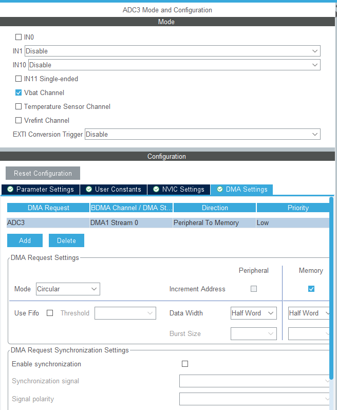

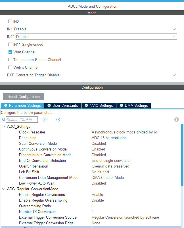

ADC3 configuration
ADC3 DMA configuration

> sConfig.SamplingTime = ADC_SAMPLETIME_1CYCLE_5;
Slow down the rate of conversions so it isn't stuck in interrupts forever.

Which DMA infinite loop?
2026-03-27 8:41 AM
2026-03-27 9:40 AM
Thanks for your answer. I change SamplingTime to maximum 810.5 cycles and now works.
My ""DMA infinite loop" seams the processor where stuck in DMA interrupts forewer as you say.
