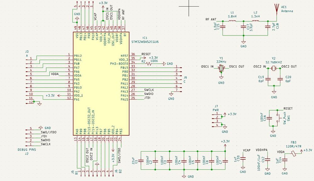

Below is my schematic attached:
I have exposed all the pins.

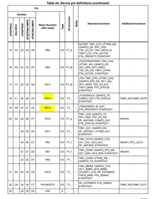

As I can see on your schematic, you are using the PA13 as SWCLK and PA14 as SWDIO. But as you can see on the Table 24 of the DS14127, PA14 is the SWCLK pin and PA13 is the SWDIO pin:

Please post the schematic of your board.

I have attached the schematic above. Please check.

PA14 is the SWCLK pin and PA13 is the SWDIO pin i swaped the pins and it detected the mcu but I am getting Target is not responding message every time I try to run or debug the BLE_heartrate_ota example for stm32wba52.
