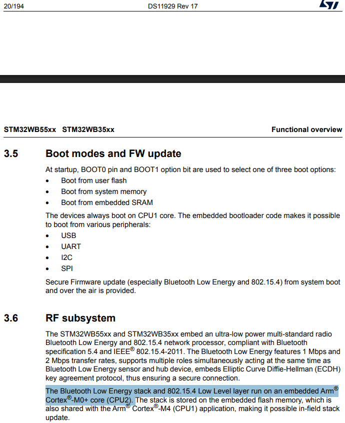

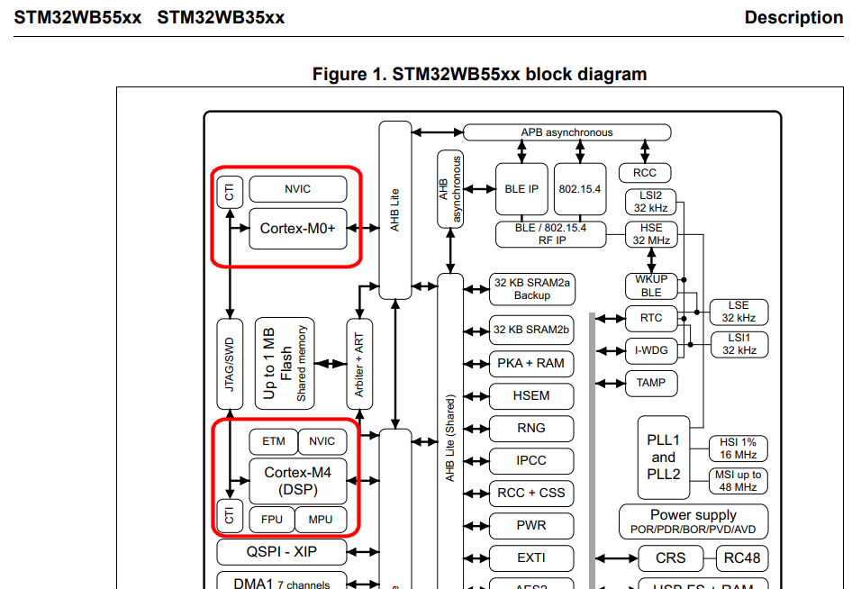

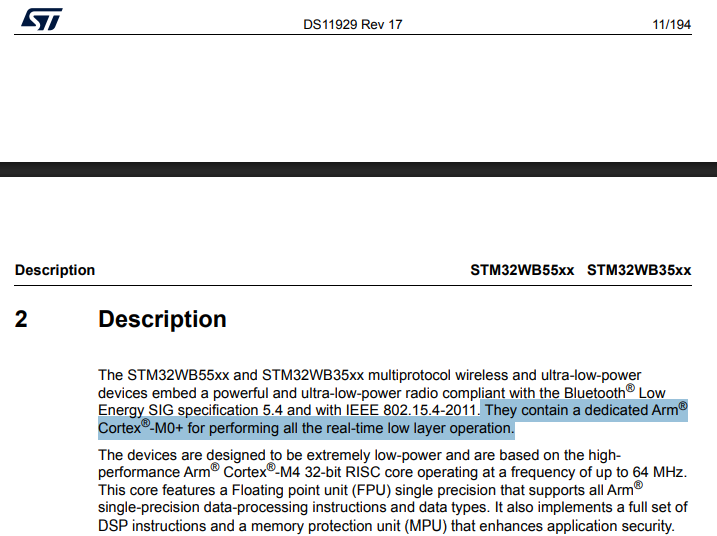

@Ricko wrote:that datasheet it does not mention anything about a second core?
It does here:
and here:
https://www.st.com/resource/en/datasheet/stm32wb55vg.pdf#page=21
I guess the point is that the M0+ is dedicated to the radio, and not available to the user ?
PS:
also:
