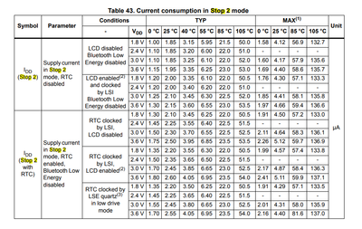

Hello @SDhar.1,
All the low power modes current measurements are available in the STM32WB55xx datasheet
For STOP 2 mode RTC enabled, check this table:

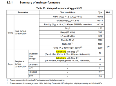

2024-10-09 4:55 AM
What is the current consumption when the MCU is in STOP2 mode and Bluetooth is advertising?
If anyone has measured this or has any information, please share your findings. Any tips on optimizing power consumption in this scenario
2024-10-09 8:28 AM
Hello again @SDhar.1,
When the STM32WB5MMG MCU is in STOP2 mode and Bluetooth is advertising, the current consumption can vary based on the advertising interval, the number of channels used, and the transmission power.
Please check the following values in datasheet:
