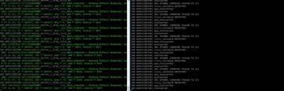

After reviewing your code I made a quick application Server/Client implementing the Color Control Cluster to test its functions, especially step_color_xy command as you mentioned on the post, and it's working as expected.
Actually the application is based on 2 Nucleo boards, 1 coordinator Client and 2 is a router Server.
After establishing the connection, you can send a step_color_xy command over the function ZbZclColorClientStepColorXYReq that should be received on the Server side by pressing SW1 button.
For that, I added a callback returning the status of the command and the response, as you can see in the capture below, the response returns 0 ( success) and the callback is received by the server "colorControl_server_1_step_color_xy"
Please find below Zigbee code source for both Server/Client for test.

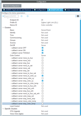

This is my Configuration in CubeMX:
I used this post https://community.st.com/t5/stm32-mcus-wireless/stm32wb55-color-control-cluster-gives-an-assertion-error/td-p/117097 and added
.capabilities = ZCL_COLOR_CAP_XY
To see which commands are coming, I implemented full functionality to the OnOff functions from the examples and to the functions colorControl_server_1_move_to_color_xy and colorControl_server_1_step_color_xy I added a Uart output each, to understand wether the function was called or not.
If it helps, I can also upload my .ioc or even the complete CubeIDE project. Or do you already see something missing here? As I mentioned, the OnOff functionality works flawless.

thank you for the effort. I have uploaded the server code to my board and tested it.
The result is the same, OnOff commands are received, but nothing regarding the color control.
I will now search for the problem on the Homeassistant side.
