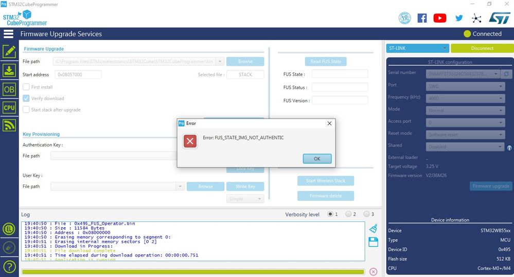

One more think i have do is install latest version of STM32 cube programmer and try to program stack but it shows image authentication error as below.
I have pick stack and FUS binaries from C:\Program Files\STMicroelectronics\STM32Cube\STM32CubeProgrammer\bin\STM32WB5x (For windows)
Does this be the issue? Does i need authentic stack binaries from ST or something?

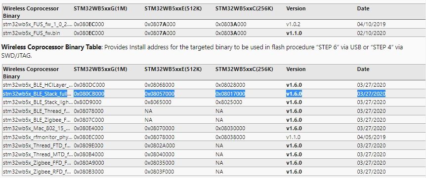

FUS binaries have to be those being part of the official CubeWB FW package under
STM32Cube_FW_WB_V1.8.0\Projects\STM32WB_Copro_Wireless_Binaries\STM32WB5x.
You can use the v1.9 version now as it has been officially released last week.
Not that you must not update the FUS again with aversion which is already installed.
Once connected in USB DFU mode, have a look a 0x20030030 to get the FUS version. Based on the result, you will know if you have to upgrade the FUS with a newer version.
