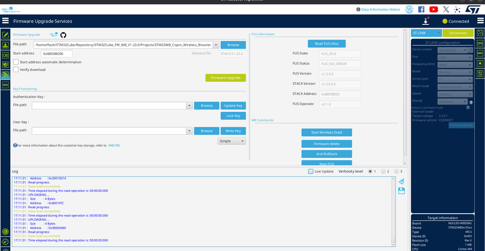

I wanted to develop BLE application using the nucleo stm32wb55rg and the zephyr project v4.3.0. what i did is take a nucleo stm32wb55rg board first i upgraded the FUS from the STM32Cube/Repository/STM32Cube_FW_WB_V1.23.0/Projects/STM32WB_Copro_Wireless_Binaries/STM32WB5x/stm32wb5x_FUS_fw_1_2_0.bin
then after this i updated the wireless stack firmware with this one STM32Cube/Repository/STM32Cube_FW_WB_V1.23.0/Projects/STM32WB_Copro_Wireless_Binaries/STM32WB5x/stm32wb5x_BLE_HCILayer_extended_fw.bin.
after this i power cycle the board, which is required for the wireless stack to load.
