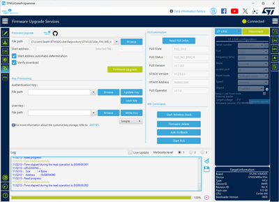

Here is the end of updating the FUS and the problem programming the stack:
Followed by this error when trying to start the wireless stack that isn't there:
Thanks in advance for any help!
2025-10-11 11:05 AM
I don't get the same problem when trying to program the wireless stack binary via the GUI:
And after programming it via the GUI, programming it via the CLI now works.
