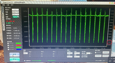

Test 1:
With the original ble_zigbee_SED_Dyn.hex source code:
1.1 When the development board connects successfully to both the Zigbee (Home Assistant Zigbee hub) and ST BLE app, it enters low-power mode with a current of 300-400 µA.

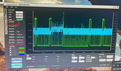

1.2 When connected only to the ST BLE app and not to Zigbee, the average power consumption is 4-5 mA, with a minimum of 2.7-3 mA.

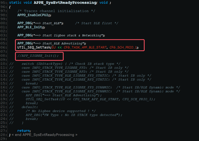

Test 2:
Disabling the Zigbee initialization code.
Test Results: The development board failed to connect to the ST BLE app, and the Bluetooth device was not visible in the ST BLE app.

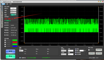

Test 3:
With both Zigbee and BLE initialized, Zigbee does not connect and is set to low-power mode.
Code Changes: The code modifies the APP_ZIGBEE_NwkForm function to set Zigbee into low-power mode after a single broadcast.

Test Results: The minimum current remained around 3 mA, indicating that it did not enter full low-power mode.
