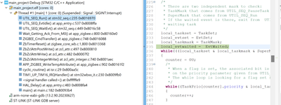

However, the debugger shows that the controller stays here, after the isr calls the ..AttrWrite..
I cannot understand a lot from the call stack, however I can also share more of the project if you need. I attached my .ioc, to see my interrupt setup.

2024-11-15 6:42 AM
Hi Oadi,
Thank you for that hint, setted the isr to lowest Prio and that did it!
