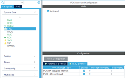

It seems that the IPCC interrupts are note activated on your IOC file making the communication impossible between M0/M4, the app_zigbee_init will not be called in this case.
Please activate the IPCC Tx and Rx interrupts as follow and give it a try :
Best regards,
Best regards,

Hi Ouadi,
