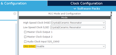

did you set the lse+hse in Cube ? and flash this program then ?
otherwise cpu running on internal clock only.

2023-07-16 6:39 AM
so this is first problem, you have to care about.
without loading a program - no external clocks running.

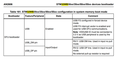

2023-07-17 9:26 AM
Your choiced bootloader load isnt native suppoerted in IDE. You need handle load sw manualy or over script. Too you cant debug with this setup. Why you choice this?
