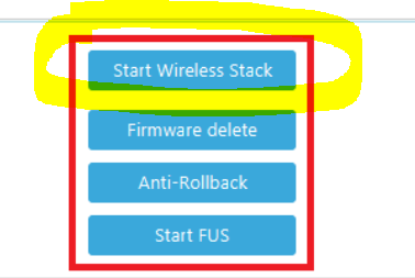

Hello @AkashJoseSaji and welcome to the ST Community :smiling_face_with_smiling_eyes:.
I suggest you start the wireless stack after the Firmware and stack upgrade (click on the mentioned button):

This is a new question I suggest you close this ticket as answered and open a new one mentioning all screenshots from CubeProgrammer (how you did the update process, what is the source of your FUS and Stack that you are using and from which version of the STM32CubeWB is coming, what is the address you are using when uploading the FUS and Stack and finally when testing it with one of our example (P2P server or BLE_Heart_Rate) do you have any problem).
PS: ensure using the Last versions of the STM32Cube Tools and FW. And don't forget to start your wireless stack after the Stack and FUS update as mentioned in the first Comment.
