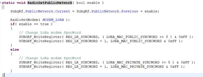

What is the default public network mode in LoRa ping pong example? There is a function of RadioSetPublicNetwork which can be configured, but if we do not configure it at all, what will be the default mode? Public or Private?
Also, how can I set my own private syncword? I thought it doing like this, but compiler is generating implicit declaration error in SUBGRF_WriteRegister() function

Thanks for your response, but how can I set my own sync word, default is 0x1424, but let's say I want to set 0x1122, how can I do that? Should I include radio_driver.h file and call SUBGRF_WriteRegister() directly, or there is any other better alternative out there?
2024-07-11 3:04 AM
Hello @pho3nix
To set the SyncWords values you have to use the function "uint8_t SUBGRF_SetSyncWord( uint8_t *syncWord );" available on the radio_driver.h.

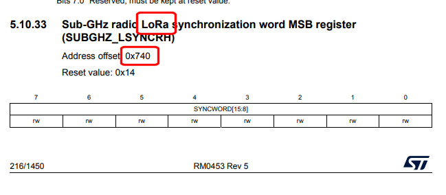

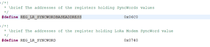

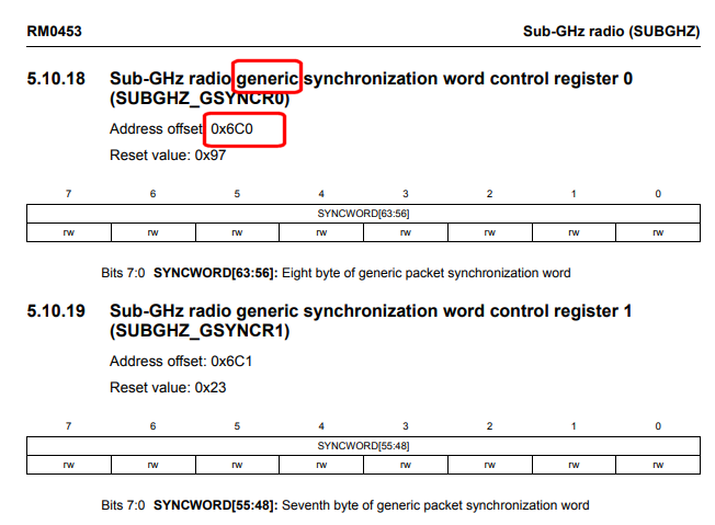

Thanks, but I have a confusion, what are the difference between these two register addresses
is REG_LR_SYNCWORD only used for LoRa, and REG_LR_SYNCWORDBASEADDRESS is generic, like is it common for LoRa, FSK and other modulation techniques?

Exactly.
More details available on the register definition of the Chapter 5 of the RM0453.

2024-07-11 7:06 AM
That is what the RM says:
