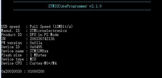

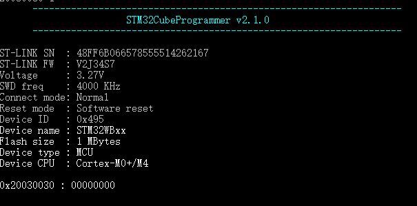

2019-07-29 7:47 PM
I found that the ICs (stm32wb55RGV6) which i bought had no FUS.
As shown below
Is it normal situation? Should i need to download and install
DFU at first?
Thanks.

2019-08-05 8:49 AM
No FUS on your chip is not a normal situation. So load FUS V1.0.1 in your case before going any further in the update of the BLE stack.
You wrote
then , i installed the stm32wb5x_FUS_fw.bin on 0x080EC000 => No error?
stm32wb5x_BLE_Stack_fw.bin on 0x080CC000 => OK
stm32wb5x_BLE_HCILayer_fw.bin on 0x080DC000. => No as the previous binary is enough.
The first install is required but you have to check it is the V1.0.1 version.
Then only the stm32wb5x_BLE_Stack_fw.bin fw is needed.
The stm32wb5x_BLE_HCILayer_fw.bin is only the HCI layer which can be used when you already have your own application stack for the M4 core. I assume it is not your case.

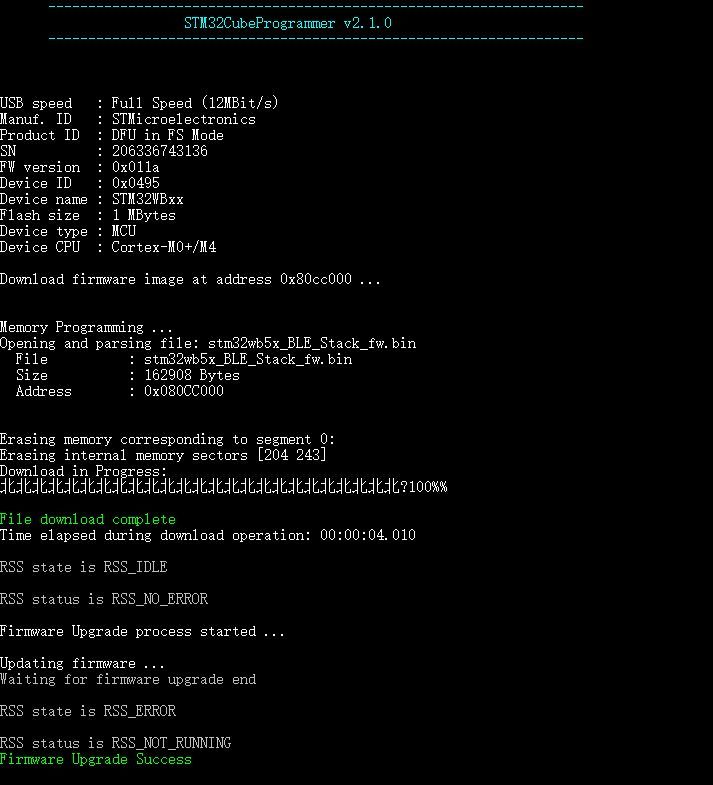

2019-08-07 7:12 PM
Hi ,
This is the FUS version i installed.
Then, I installed the stm32wb5x_BLE_Stack_fw.bin.
But , the prgram still can't enter into APP_BLE_Init( ); .
The only working is M4 core.
Thank you .
2019-08-08 2:15 AM
The RF stack update looks OK.
