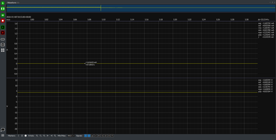

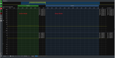

I have run the example firmware (PWR_STOP2_RTC) from the STM32WL SDK as suggested. However, the measured current consumption is still around 1.6 mA in sleep mode. Please find the attached image for reference.

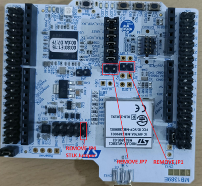

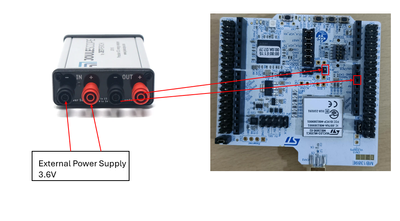

Please find the attached image showing the current measurement setup for the NUCLEO-WL55JC1 board.
let me know if there is anything incorrect or that needs to be improved.

hello @Deep23
Did you ensure to place the jumpers in their correct new positions after removing them from the STLINK position? because you didn't mention where you placed them.
You can refer to this user manual to see how to configure jumpers for each power source.
Also, as an initial test, first run the test while powering the board from STLINK to ensure that the product can enter stop mode.
