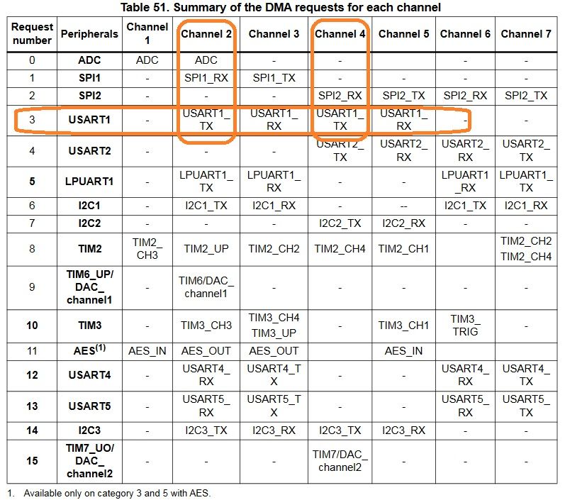

USART1 is REQUEST 3, Channel 2 or 4, check also hard references in VCOM.C
/* Definition for USARTx's DMA */
#define USARTx_TX_DMA_CHANNEL DMA1_Channel7
/* Definition for USARTx's DMA Request */
#define USARTx_TX_DMA_REQUEST DMA_REQUEST_4

USART1 work with channel 4 but not with channel 2
#define USARTx_TX_DMA_CHANNEL DMA1_Channel4
