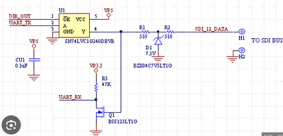

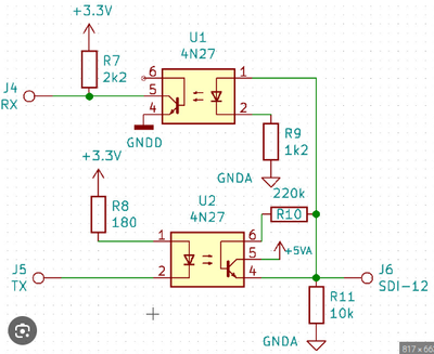

from search, typical interface :
| Using UART for SDI-12 interface |
