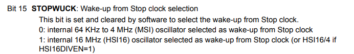

Hello @chai2145,
The key point is the STOPWUCK bit. The RM states:
"MSI or HSI16 RC oscillator are selected as system clock for Stop mode exit by configuring the STOPWUCK bit in the RCC_CFGR register"
Hope that helps!
2025-09-07 7:55 PM
Before STOP: System clock using MSI. Nothing changes yet.
Enter STOP → system goes into low-power mode. Configured STOPWUCK bit to use HSI
Exit STOP → system will switch to HSI as the system clock.
After STOP exit, the system clock will change to HSI instead of maintaining MSI as system clock source?
