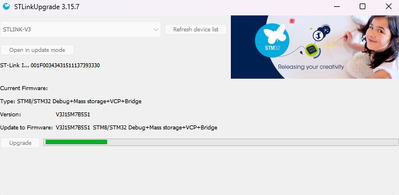

I am able to see it on the STLink Upgrade utility which is in the cube ide.

If you remove the JP2, you will not be able to program or debug any code. If not, can you please try to upgrade the St-link firmware using CubeMX. Can you also ensure that you are using a data cable and not just a charging one.

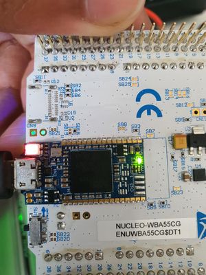

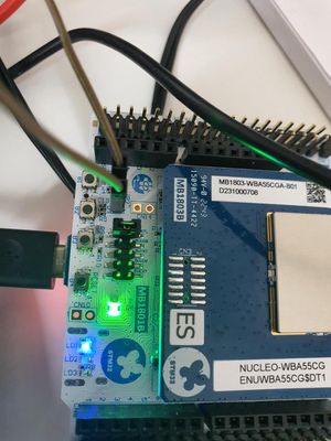

I can confirm my JP2 and JP1 jumpers are on. I have attached some additional pictures to this.

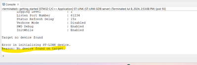

I am using cube ide for this project, you can see through that, i am able to program up the stlink chip
When it comes to flashing it says no device found on target. i can confirm that my reset configuration is "Connect under reset"

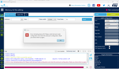

@STTwo-32 Ty for your suggestion.
I have tried using stm32cube programmer but it can't seem to detect it at all (below is an image). I've tried UART, st-link and USB. None of them seem to detect it.
My device manager does detect it as shown from the image.
2024-07-08 8:21 AM
I think the MCU is broken in this case. I suggest you try using another Board or change the MCU.
