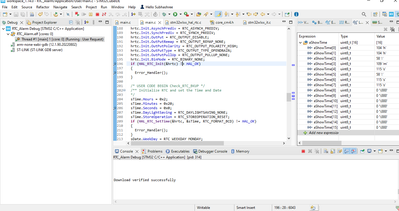

I tried the RTC_Alarm example folder, at first it worked out well and I was able to view the output.
But when I ran for the 2nd time without any changes in the code the execution stopped at
HAL_RTC_Init ->> (if (HAL_RTC_Init (& RtcHandle)! = HAL_OK)). And it didn't get through the if loop also.
And strangely when I upload some other code and reset the board (STM32WL55 Nucleo board) and again when I upload the RTC_Alarm code it works fine and again when I upload the same code the 2nd time the code is freezing.
What should I do and where I am going wrong here..

Hello @Subha_shree_bask
I've tested personally (with different boards) but I can't find any issue. Could you send some data about the issue ( screenshots,...).
Best Regards.
STTwo-32
For RTC use cases, this behavior is normal when debbuging since RTC clock configurations are modified what could generate different issues on the RTC.
Best Regards.
STTwo-32
