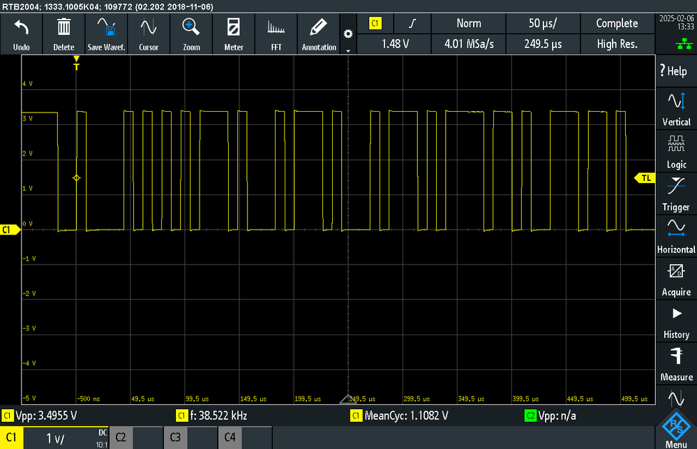

I'm not clear what that scope trace is supposed to be showing?
2025-02-06 2:59 AM

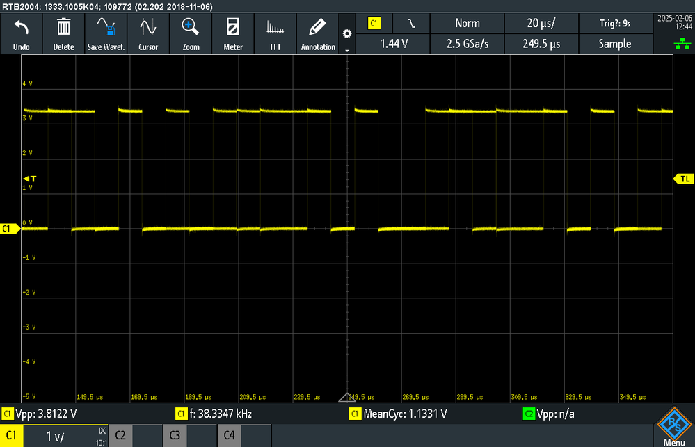

The scope image shows a strong jitter. Here at 115200 baud the jitter is not as strong, but still present.
2025-02-06 3:15 AM
What do you mean by "jitter"?
You won't get a steady scope display unless the data being sent is constant!
So either:
2025-02-06 4:54 AM
Yes, the measurement method is probably not optimal. It looks better with a single shot, but when I measure the oscilloscope image precisely, I counted the number of bits in it from your trigger point (-500ns) to 399.5 µs.
I counted 46 bits in 400 µs, which gives 8.69565217... µs/bit, which is exactly 115000 baud and not 115200!
115200 baud would correspond to a length of 399.3 µs for 46 bits, so the edge change in the last bit should come a little BEFORE the raster line, but in the image it is more after it.
All in all, this corresponds to a deviation of 0.17% and I don't think it should be a problem.

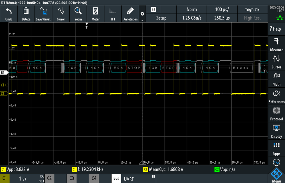

Here i used the Protocoll measurement method with 19200 baud and PCLK2 as clock source for USART1:
And here I occasionally get an error when I get data from the NUCLEO board when I press button 1.
