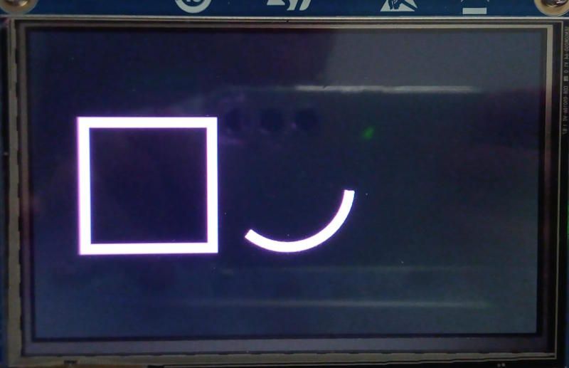

I'm trying to use the GPU2D on the STM32N6570-DK, with NemaGFX.
However, the GPU hangs on random functions.
Well actually every time the same funtions, but depending on the number of functions to be executed, so it seems it can only execute a limited number of functions, and the it hangs.
And many of these doen't even complete the drawing of the shape.

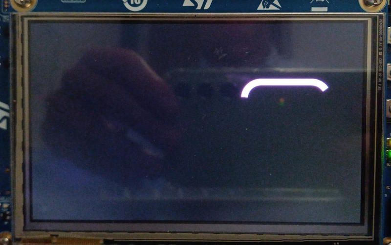

The nema_vg_draw_circle doesn't complete drawing the circle and hangs.
When only drawing the rounded rectangle results in an incomplte draw and hang of the function:
If I remove some functions, the app hangs on nema_cl_wait.
I think it might be related to the buffer initialization in nema_hal.c, or that nema_hal.c contains other errors.

  printf("nema_calls...\n");
  /* Circle */
//  NemaGFX.fbos[buffer_pixel].bo = nema_select_framebuffer(buffer_pixel);
  NemaGFX.fbo.bo = nema_select_framebuffer(buffer_pixel);
  printf("nema_cl_create_sized\n");
  NemaGFX.cl = nema_cl_create_sized(8192);
  nema_cl_bind_circular(&NemaGFX.cl);
  printf("nema_bind_dst_tex\n");
//  nema_bind_dst_tex(NemaGFX.fbo.bo.base_phys, NemaGFX.fbo.w, NemaGFX.fbo.h, NemaGFX.fbo.format, NemaGFX.fbo.stride);
//  nema_bind_src_tex(NemaGFX.fbo.bo.base_phys, NemaGFX.fbo.w, NemaGFX.fbo.h, NemaGFX.fbo.format, NemaGFX.fbo.stride, NEMA_FILTER_PS);
#if (DISPLAY_BYTES_PER_PIXEL == 3)
  nema_bind_dst_tex(GFXMMU_VIRTUAL_BUFFER0_BASE, NemaGFX.fbo.w, NemaGFX.fbo.h, NEMA_RGBA8888, -1);
  nema_bind_src_tex(GFXMMU_VIRTUAL_BUFFER0_BASE, NemaGFX.fbo.w, NemaGFX.fbo.h, NEMA_RGBA8888, -1, NEMA_FILTER_PS);
#else
//  nema_bind_dst_tex(NemaGFX.fbo.bo.base_phys, NemaGFX.fbo.w, NemaGFX.fbo.h, NemaGFX.fbo.format, -1);
//  nema_bind_src2_tex(NemaGFX.fbo.bo.base_phys, NemaGFX.fbo.w, NemaGFX.fbo.h, NemaGFX.fbo.format, NemaGFX.fbo.stride, NEMA_FILTER_BL);
#endif
  printf("nema_set_clip\n");
  nema_set_clip(0, 0, DISPLAY_SIZE_W, DISPLAY_SIZE_H);
//  printf("nema_enable_depth\n");
//  nema_enable_depth(0);
//  printf("nema_debug_overdraws\n");
//  nema_debug_overdraws(0);
//  nema_set_const_color(0xFF0000FF);
//  nema_set_src_color_key(0xFF0000FF);
//  nema_set_dst_color_key(0xFF0000FF);
//  nema_set_recolor_color(0xFF0000FF);
//  nema_set_blend_fill(NEMA_BL_SIMPLE);
  nema_set_blend_fill(NEMA_BL_SRC_OVER);
//  nema_set_blend_fill(0x00000000);
//  nema_set_blend_blit(NEMA_BL_SRC_OVER);
//  nema_blending_mode(nema_blend_factor_t src, nema_blend_factor_t dst, nema_blend_op_t ops);
//  nema_blending_mode(NEMA_BF_DESTCOLOR, NEMA_BF_INVSRCALPHA, NEMA_BLOP_SRC_PREMULT);
//  nema_set_blend_blit(nema_blending_mode(NEMA_BF_ONE, NEMA_BF_INVSRCALPHA, NEMA_BLOP_SRC_PREMULT));
//  nema_set_blend_blit(nema_blending_mode(NEMA_BF_SRCALPHA, NEMA_BF_INVSRCALPHA, NEMA_BLOP_MODULATE_A));
  nema_blending_mode(NEMA_BF_SRCALPHA, NEMA_BF_INVSRCALPHA, NEMA_BLOP_MODULATE_A);
  printf("nema_vg_paint_create\n");
  NemaGFX.paint = nema_vg_paint_create();
  nema_vg_paint_clear(NemaGFX.paint);
  nema_mat3x3_load_identity(NemaGFX.m);
  nema_mat3x3_translate(NemaGFX.m, 0.0, 0.0);
  nema_mat3x3_rotate(NemaGFX.m, 0.0);
  nema_mat3x3_scale(NemaGFX.m, 1.0, 1.0);
  printf("nema_vg_paint_set_type\n");
  nema_vg_paint_set_type(NemaGFX.paint, NEMA_VG_PAINT_COLOR);
  nema_vg_paint_set_opacity(NemaGFX.paint, 1.0);
  nema_vg_paint_set_paint_color(NemaGFX.paint, nema_rgba(0xFF, 0x00, 0xFF, 0xFF));
  nema_vg_stroke_set_width(15.0);
//  nema_vg_set_fill_rule(NEMA_VG_FILL_EVEN_ODD);
  nema_vg_set_blend(NEMA_BL_SRC_OVER | NEMA_BLOP_SRC_PREMULT);
//  nema_vg_set_blend(NEMA_BL_SRC_OVER); /* No sharp rectangle! */
//  nema_vg_set_blend(NEMA_BL_SRC_OVER | NEMA_BLOP_RECOLOR); /* No sharp rectangle! */
//  nema_vg_set_blend(NEMA_BL_SRC_OVER | NEMA_BLOP_STENCIL_XY);
//  nema_vg_set_blend(NEMA_BL_SRC_OVER | NEMA_BLOP_NO_USE_ROPBL);
//  nema_vg_set_blend(NEMA_BL_SRC_OVER | NEMA_BLOP_MODULATE_RGB); /* No sharp rectangle! */
//  nema_vg_set_blend(NEMA_BL_SRC_OVER | NEMA_BLOP_SRC_CKEY);
//  nema_vg_set_blend(NEMA_BL_SRC_OVER| NEMA_BLOP_SRC_PREMULT | NEMA_BLOP_SRC_CKEY);
//  nema_vg_set_blend(nema_blending_mode(NEMA_BF_SRCALPHA, NEMA_BF_INVSRCALPHA, NEMA_BLOP_MODULATE_A));
//  nema_vg_set_blend(nema_blending_mode(NEMA_BF_SRCALPHA, NEMA_BF_INVSRCALPHA, NEMA_BLOP_MODULATE_RGB | NEMA_BLOP_MODULATE_A));  /* Takes A, non-AA */
//  nema_set_blend_fill_compose(NEMA_BL_SRC_OVER);
#if 1
  printf("nema_enable_aa_flags\n");
  nema_enable_aa_flags(1);
  nema_enable_aa(1, 1, 1, 1);
#endif
#if 1
  /* This is required to get well rounded corners and avoid displaying a 45 degrees rotated square! */
  printf("nema_vg_set_quality\n");
  nema_vg_set_quality(NEMA_VG_QUALITY_MAXIMUM);
#endif
  nema_vg_set_fill_rule(NEMA_VG_FILL_NON_ZERO);
  printf("nema_vg_draw_rect\n");
  nema_vg_paint_set_paint_color(NemaGFX.paint, nema_rgba(0x00, 0x00, 0x00, 0xFF)); // Black
  nema_vg_draw_rect(0, 0, 800, 480, NemaGFX.m, NemaGFX.paint);
  nema_vg_set_fill_rule(NEMA_VG_STROKE);
  nema_vg_draw_rect(80, 140, 200, 200, NemaGFX.m, NemaGFX.paint);
#if 0
  printf("nema_vg_draw_circle\n");
  nema_vg_draw_circle(400, 240, 100, NemaGFX.m, NemaGFX.paint);
#endif
#if 0
  printf("nema_vg_draw_rounded_rect\n");
  nema_vg_draw_rounded_rect(520, 140, 200, 200, 40, 40, NemaGFX.m, NemaGFX.paint);
#endif
  printf("nema_cl_unbind\n");
  nema_cl_unbind();
  printf("nema_cl_submit\n");
  nema_cl_submit(&NemaGFX.cl);
  printf("nema_cl_wait\n");
  nema_cl_wait(&NemaGFX.cl);
  printf("nema_cl_destroy\n");
  nema_cl_destroy(&NemaGFX.cl);
  printf("nema_vg_paint_destroy\n");
  nema_vg_paint_destroy(NemaGFX.paint);
  printf("Done\n");
I noticed that the m55 NemaGFX works well with NEMA_RGB565, but not at all with NEMA_BGR565, which also took me a while to figure out. So there could be more surprises why it's not working right now.
I probably forgot something important.
Any help is appreciated.
BTW, on a STM32U5G9J-DK2 (m33) all works fine!
I posted my test project on hithub:
https://github.com/AngryCarrot61/STM32N6-digits-lcd
I noticed the versions below:
STM32U5x9 v3.5.0 - Works fine, no problems at all
STM32H7RS v1.3.0 - Reveals rendering issues with the vg libraries
STM32N6 v1.3.0 - Reveals rendering issues with the vg libraries
So I assume the NemaGFX v1.3.0 versions for the m7 and m55 aren't finished yet, regarding the vg libraries.
I also noticed the STM32N6 has a bug when using the NEMA_BGR565 format, while NEMA_RGB565 works fine.

Hi @Jack3
Yes I think your right it looks like the memory pool runs full or something related to the command list or ring buffer.
I see you have access to the NeoChromSDK for STM32N6, did you have a look at the examples that is part of this package?
A suggestion is to take for instance the example
\NeoChromSDK\Projects\STM32N6570-DK\Applications\GPU2D\vector_watchface\
And replace the contents of app_main() with your own drawing code.
In this application the memory setup should be okay.
Making sure it works you can compare your nema_hal.c with the nema_hal_threadx.c of the application.
The threadx part of the nema_hal file is isolated to the way the sync with the LTDC is configured.
Also in case you did not see it there is a small starting guide here:
\NeoChromSDK\NeoChromSDK_README.pdf
More detailed documentation is here:
\NeoChromSDK\Middlewares\Third_Party\NemaGFX\doc\
NB. the STM32N6 and STM32H7R/S only supports thge 16bit format called: NEMA_RGB565. I guess you found out the hard way. This could definitely have been stated more clearly somewhere in the documentation. I will flow that comment to the backend team.
Hope it helps

Thanks, Jakob!
That was exactly what I was looking for!
I accidentally searched for nema_hal.c and that way didn't find nema_hal_threadx.c.
The buffers are initialized differently, so that gives me hope.
I'll give you feedback once it works.
