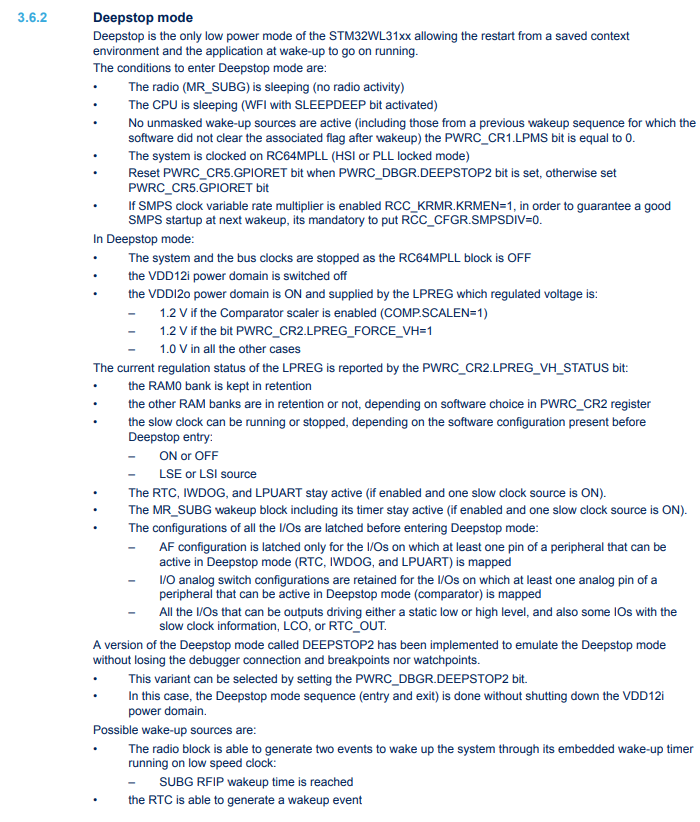

Hello @sbelcatronic ,
Make sure that all configuration steps and conditions mentioned in the Datasheet (page 14 - section: 3.6.2 Deepstop mode) are followed:
  • The radio (MR_SUBG) and CPU are sleeping (WFI with SLEEPDEEP bit set).
  • No unmasked wake-up sources are active (PWRC_CR1.LPMS = 0).
  • The system is clocked on RC64MPLL (HSI or PLL locked mode).
When your question is answered, please close this topic by clicking "Accept as Solution".
Thanks
Imen
