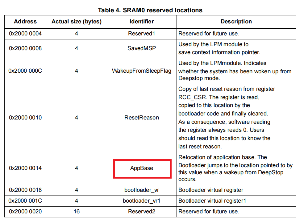

Hello @marvdm@xy3dg12 and @sbelcatronic
I would like to share an update following our internal review of this topic.
First, please note that after wake-up from DeepStop, the STM32LWL31 device is not intended to resume from the previous execution point. Instead, it is designed to restart from reset.
We also found that the proposed workaround from @xy3dg12 of manually writing AppBase may not be safe. It seemed to work only because the current STM32LWL31 linker file does not place the RAM_VR structure at the correct address.
A fix will be included in a future STM32CubeMX release. In the meantime, a practical workaround is to use the STM32LWL33 linker file.
BR
Gyessine

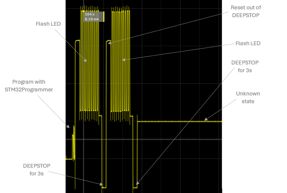

I've taken a step back and setup a loop to test the RTC wakeup timer without DEEPSTOP:
while (1) {
  // Toggle LED
  HAL_GPIO_TogglePin(LED_BLUE_GPIO_Port, LED_BLUE_Pin);
  HAL_PWREx_EnableInternalWakeUpLine(PWR_WAKEUP_RTC, PWR_WUP_RISIEDG);
  HAL_RTCEx_DeactivateWakeUpTimer(&hrtc);
  __HAL_PWR_CLEAR_FLAG(PWR_FLAG_RTC);
  // Setup wakeup after 3s: 32kHz/16 = 500us * 6000 = ~3s
  HAL_RTCEx_SetWakeUpTimer_IT(&hrtc, 6000, RTC_WAKEUPCLOCK_RTCCLK_DIV16);
  // Wait for RTC wakeup flag
  while (!__HAL_PWR_GET_FLAG(PWR_FLAG_RTC));
For above code I observe the BLUE LED toggle every 3s, as expected. I also confirmed RTC_IRQHandler() fires correctly.
However, when I add the code to config & enter DEEPSTOP, I get the same problem.
I've profiled the current consumption (see picture below), and it seems as if the device exits DEEPSTOP correctly the first time after programming. However, it seems to not exit DEEPSTOP the second time - it goes into an unknown state indefinitely where it draws ~7mA, and no code is executed.
I don't know if this is relevant, but the hardware platform does not implement the SMPS - there is no specific setup made in code for this, and I don't know if it is relevant to the behavior in DEEPSTOP.

Hi all,
I have the same behaviour with STM32WL31 in deep stop and wakup from IO Pins. I tested succefully the project PWR_DEEPSTOP on the demoboard NUCLEO-WL33CC2 (this mount a different micro STM32WL33). When I write the code  PWR_DEEPSTOP on my board that use WL31 microcontroller I have the same behaviour as decribed from MARVDM; after programmed the micro it seam to enter in deep stop and when I perss the wakeup pin it exit from deep stop, execute the main and go back in deep stop. If I wakeup again by the IO pin it not exit from deep stop but look like in an udefined state. From this state, if I reset by the NRST pin it restart, execute the main enter in deep stop but if I wakenup by IO pin it go in undefined state again.
Any idea?
Check this :
sbelcatronic
Associate III
Thank you xy3dg12,
your suggestion was correct: I added this line:
*(uint32_t*)0x20000014 = 0x10040000;
 and look like solved my problem.
But I do not undestend why this solved my problem. Why my firmware enter in bootloadr when wakeup from DeepStop? Why did the first wake-up after downloading the firmware work, but the others didn’t? Why the demoboard NUCLEO-WL33CC2 have not the same problem?
In my opinion all of this smells like a BUG and the added line of code is just a workaround!
Simone
