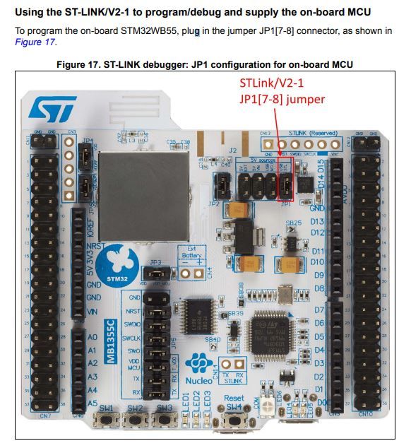

Check if all jumpers are correctly configured :
Imen

I have the exact same problem. And I am a fairly experienced STM32 user. Yes, JP2 and JP3 are on. Yes, JP1 [7-8] on. Yes, the red LEDs are on. Yes, the latest driver, and I can see it properly in my Window's device manager. Yes, the lastest CubeProgrammer version. I was also trying to load the Heart Rate example.
