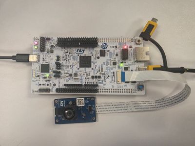

Hello everyone,
I seem to be having issues flashing some the sample binaries found in these two repositories. I am using the NUCLEO-N657X0-Q board with the B-CAMS-IMX camera module.
With either set of binaries I tried the following steps:
1. Open STM32CubeProgrammer and connect to the board using ST-LINK over USB (Boot jumpers in the depicted position)
2. Enable the MX25UM51245G_STM32N6570-NUCLEO external loader for the STM32N6570-NUCLEO board
3. Browse to the first hex file to flash under the "Erasing & Programming" tab
4. Flash each hex file in the order specified in the project's README
5. Move the BOOT1 jumper from position 2 to position 1
6. Power Off/Power on by unplugging the board from USB
From what I understand, the board should now behave like a USB webcam when connecting it to a computer though the non-STLINK USB port. Unfortunately, when trying this, my computer doesn't even recognize that device has been connected. (The corresponding light on the board does turn on though)
Since one of the projects includes source code, I also tried building and running the binary in STM32CubeIDE. The build and flash seem to complete successfully, but my computer is still unable to recognize a connection. When trying to run the debugger the program continues until line 267 in the CMW_IMX_335_PowerOn() function in the cmw_imx335.c file. At this point, the console starts to print "Target not responding, retrying..." Although, I can't say for certain if this is actually related to my issue or if this is a separate issue with the debugger since this doesn't happen when not debugging.

2025-07-04 1:32 AM
Hello @elliot-chung
Did you lunch consol application to see application message ?
Did you lunch host webcam application and check if the device is available?
2025-07-07 10:21 AM
To answer your second question, I did open up my computer's webcam application and saw that no camera was being recognized. Could you clarify what you mean by the first question though? I did try to open the COM port to see if there were any logging messages that I could use to help debug my issue. But I didn't see any output when building from source and I can't seem to access the COM port in boot from flash mode.
