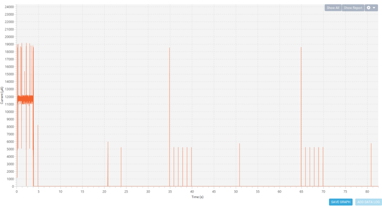

Here is the consumption over about 80 seconds

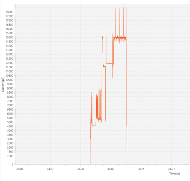

The tall spikes are the CoAP messages be transmitted

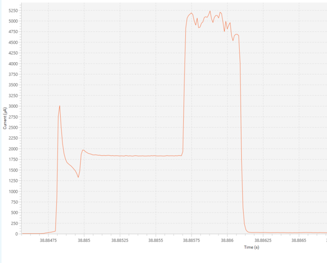

This is the shape of the 5 evenly spaced spikes following every transmitted message

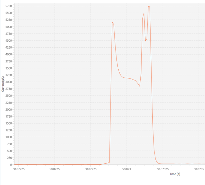

And here is the shape of the other spikes which occur intermittently

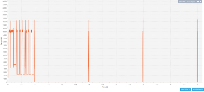

It would be very helpful if I was able to get some insight into what may be causing this - as all I changed from the example is a longer time between coap messages (this occurs the same if I include polling). Running a similar SED for zigbee does not include any activity between transmissions, as shown below
