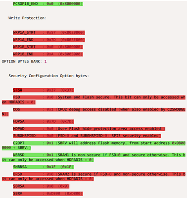

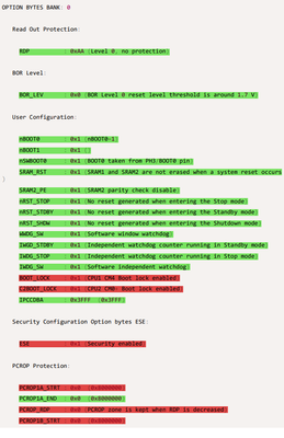

2023-07-26 6:21 AM
Hello @CGemb.1 and welcome to ST Community.
In the figures below you can find the option bytes that you need to change their values are highlighted in red. You can find their reset value in this Reference manual.
When your question is answered, please close this topic by choosing "Accept as Solution". This will help other users find that answer faster.
Issam
