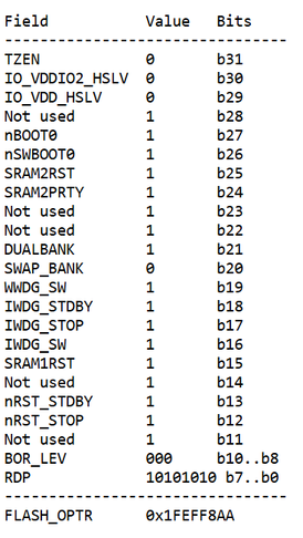

I've been digging through the STM32WBA65RI datasheet and the RM0515 STM32WBA6xxx advanced Arm®-based 32 MCUs but can't seem to locate the factory default values for the FLASH_OPTR register for the STM32WBA65.
Unliked the solution from this thread, where the RM0440's Option Bytes Descriptions section indicates ST Production Value, the RM0515's Option Bytes Descriptions section starting on page 206 doesn't contain the factory production value.
Am I missing this information elsewhere in the RM0515 or STM32WBA65RI datasheet?

Hello @cheeric ;
Please find in below the default programmed value for FLASH_OPTR.
Thank you.
Kaouthar

Hello @cheeric ;
Thank you.
Kaouthar
