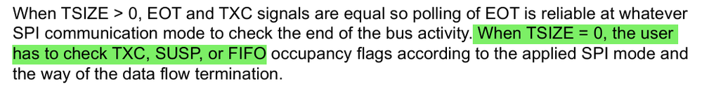

Use a fixed DSIZE, program TSIZE for each frame length, start the transfer with CSTART, and use EOT as the end of transaction flag.
The reference manual explicitly says it is preferable to program TSIZE to generate EOT when length is known. Otherwise, TSIZE must be 0.

Thanks. Having to disable and re-enable the peripheral to change TSIZE is a bit unfortunate though.
While we are at it, I wish the RM was more explicit about needing to clear TXTF (when TSIZE > 0, in addition to EOT) in the end.
