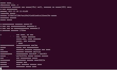

Yes, It is slower than that, we are seeing that the menu list and the relevant text to be displayed is all junk value. I have attached a screenshot of the serial logs that we are seeing on the console for your reference.

We had initially flashed our Test Application on STM32 Programmer Application to test the various peripherals attached to the MCU. The mode of communication is LPUART. After flashing the binary and running the test application on the serial console, we are seeing that the menu list and the relevant text to be displayed is all junk value. We were initially suspecting it to be a HW issue on the PCB, so to validate, we had written a basic 'Hello World' application on STMCubeIDE with LPUART initialized in the IOC File to test the TX line. Upon flashing this binary, we are seeing that 'Hello World' is successfully printing on the serial logs in the loop that we had configured it in, thus validating the HW to be working fine.

How does the text in that image compare with what you're expecting to see?
r023-12-18 15:43z09
looks like a string one might expect in a banner showing the software version.
There are many characters that seem to be non-printable. If some do get through and others not, it could be an error in the baud rate. How strongly do you know that the baud rate is accurate? Have you checked it with an oscilloscope?
Do things work better at a slower baud rate (I suggest 9600 baud)? If so, maybe your wires are too long, with too much stray capacitance for the driver chip you are using.
