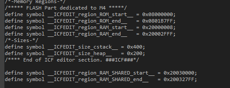

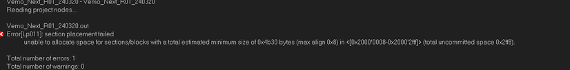

During compilation with IAR, I ran into an error. Please refer to the picture below.
Upon checking the source size via the map file, it appears as follows:
After examining the RAM size, it seems that the capacity of SRAM1 is less than 12K. I believe this shouldn't cause a compilation error.
What could be the cause of the compilation error?
