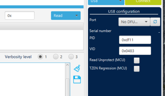

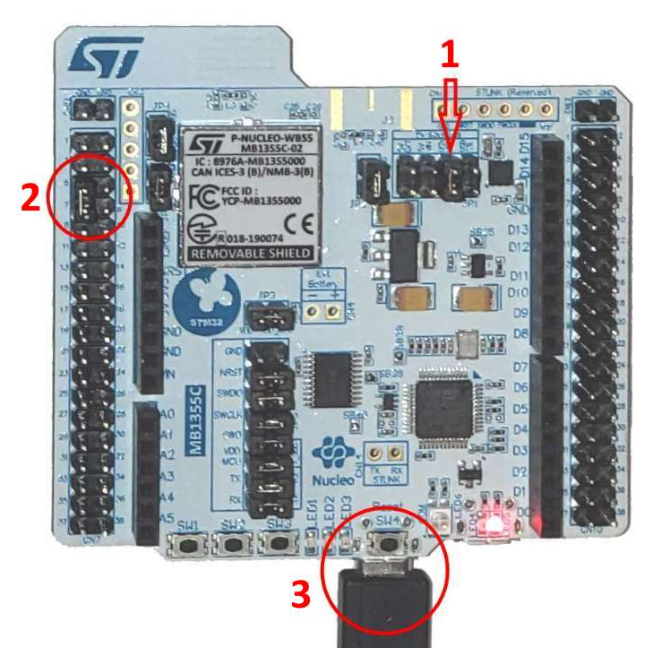

I have congigured it as picture, when i use dfu mode.I can't find usb port.
When i use usb dongle, I can download well by dfu mode.
2022-05-16 4:18 AM
I think my usb driver is ok, but i don't know why mb1355c don't work, is stm32wb55rgv6 is broken?

The nSWBOOT0 option byte should be set to 1 in order to use DFU mode.

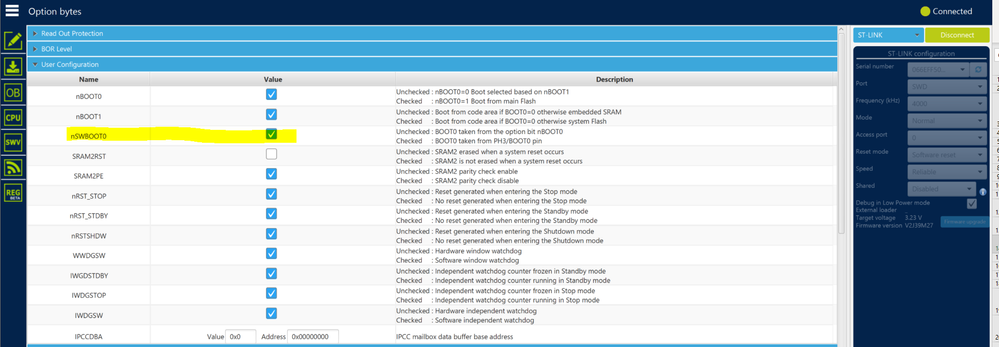

You have to connect under STLINK with STM32cubeProgrammer and change nSWBOOT0 option byte like that:
And then connect in DFU mode with you configuration.

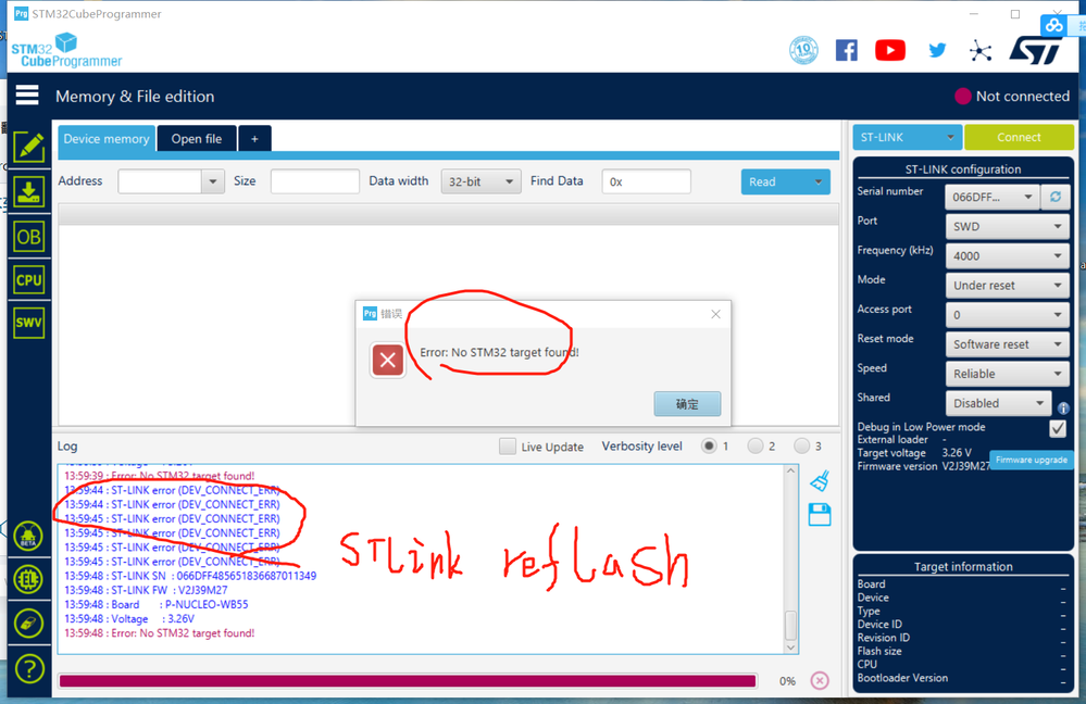

2022-05-19 11:04 PM
The reson I want to connect in dfu mode is the error 'no stm32target found', I can't connect the p_nucleo_wb55, so I can't get into this interface.(as the picture shows)

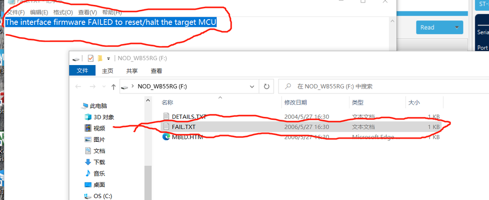

2022-05-24 7:36 PM
Thank you for always helping me, but it still doesn't work. And after I connect the P_Nucelo_WB55. Pop-up window display: error 'The interface firmware FAILED to reset/halt the target MCU'.
