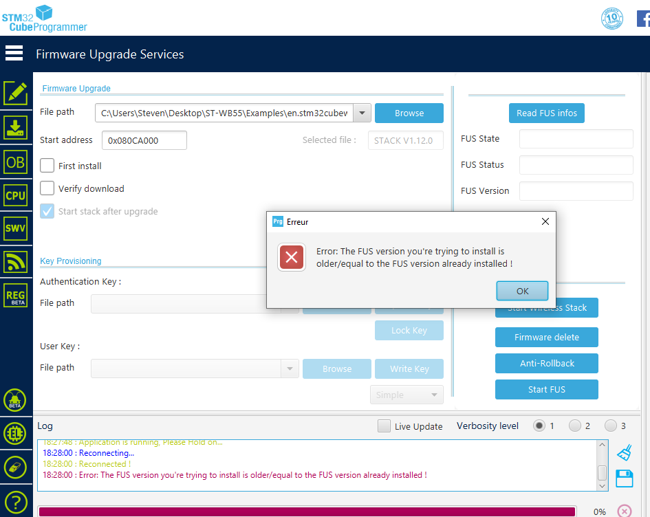

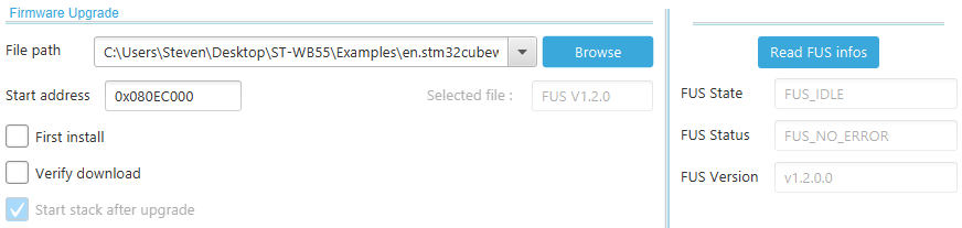

So I thought it was a problem with the wireless coprocessor firmware of the nucleo board, so I followed the guide "Release_Notes.html" in order to update the FUS and the wireless coprocessor firmware. FUS from 0.5.6 to 1.2.0 at address 0x080EC000, it worked and I get the correct version of FUS. Then, I updated the wireless coprocessor firmware "stm32wb5x_BLE_Stack_full_fw.bin" to address 0x080CA000, but there problem, "Error: The FUS version you're trying to install is older / equal to the FUS version already installed!". It is impossible to start the stack, I get the error "Error: FUS_STATE_IMG_NOT_FOUND".

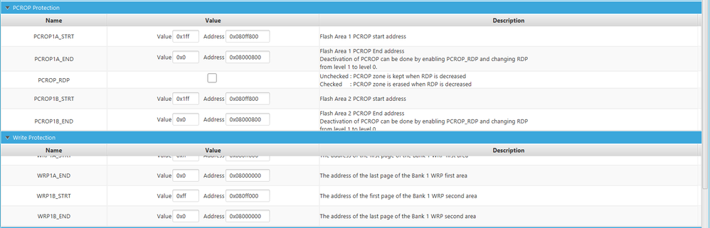

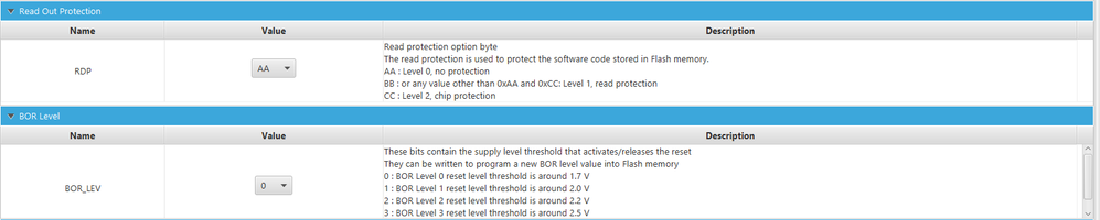

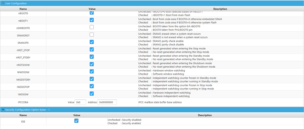

I have tried with CLI commands and the GUI, DFU and SWD, try to modify the FUS version (now impossible as it is the last version), clear memory, etc. still the same result. The options bytes are correct, except the SFSA which remains at 0xf4 even after adding the wireless coprocessor firmware.

Using CubeProgrammer, you really see the FUS version being v1.2?

Hi, I am using the WB v1.12.0 package. With CubeProgrammer, I can see the FUS with "No error" "Idle" and the version "v1.2.0". I have already erased all flash memory and tried to reload the firmware of the wireless coprocessor without success, there is always the same error.

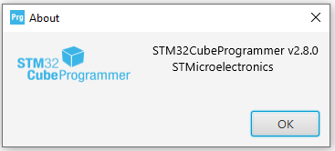

Hi, my version of CubeProgrammer was 2.7, I updated it to 2.8 but it didn't change anything, still the same problem. :\

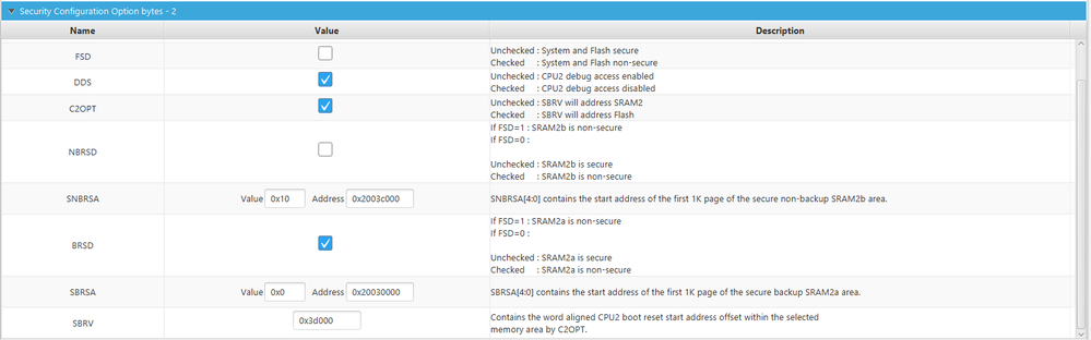

Hi, I may have activated the anti-rollback in all of my tests, I can't remember. Here is all the information requested and more.
FUS version (v1.2):
CubeProgrammer (v2.8):
FW version (v1.12) and error:
All the Option Bytes :
Target Information:

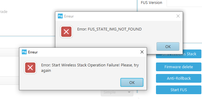

When starting Wireless Stack:
Log of the connection, the update of the wireless FW and then starting the stack (there are many errors and warnings):

18:33:18 : Error: The FUS version you're trying to install is older/equal to the FUS version already installed !

18:33:59 : Error: FUS_STATE_IMG_NOT_FOUND
18:33:59 : Start Wirless Stack failed

18:34:00 : Error: FUS_STATE_IMG_NOT_FOUND
18:34:00 : Error: Start Wireless Stack Operation Failure! Please, try again
2021-10-07 10:16 AM
I had worked on this card a few months ago, it wouldn't surprise me that I had activated the anti-rollbacks.
"Known Limitations
If Anti-Rollback needs to be activated, please make sure to activate it only after installing the latest FUS version (>= V1.2.0) and after successfully installing a wireless stack (without deleting it). Otherwise, further wireless stack installation will be blocked."
So, is there no way to fix it ? Do I have to throw my Nucleo board in the trash ?

2021-10-08 8:44 AM
The security team managed to reproduce the same case as you described..
The only happens when the Anti-Rollback is activated before installing any wireless stack or after installing a WS and deleting it.
So, we can confirm that you may have activated the Anti-Rollback .
Unfortunately, this option is irreversible ! so you wont be able to install any new FW.
The only action I can propose is to revert your board in its original manufacturing state.
To achieve this, you have to write 0x00008000 @ 0x5800040C. This should trigger the erasure of the Flash memory.
I assume activation the anti-rollback still allows this mechanism.
