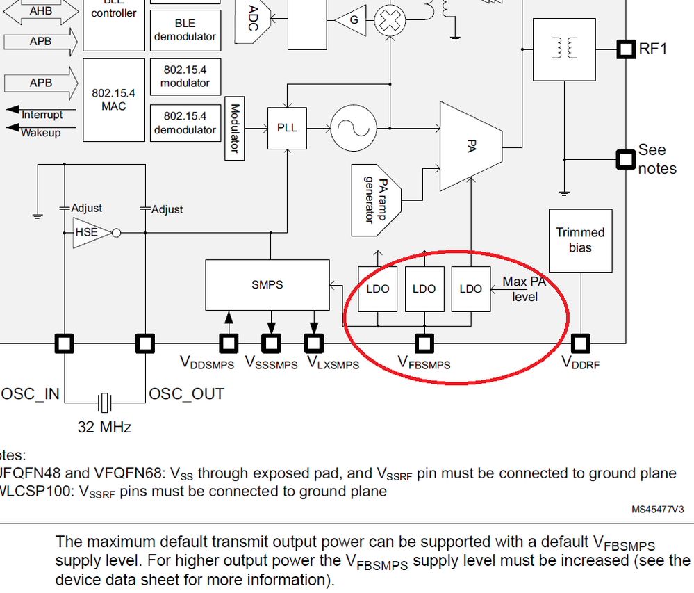

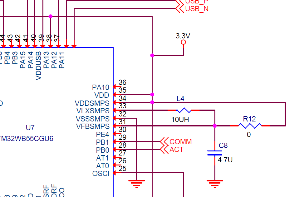

Dear Remy.
According to schematic, my board is as above that follows ST reference schematic.
VFBSMPS is fed by 3.3V. And VDD is as well.
To increase Tx power, I think I need to do 'Max PA level' in the red circle below.
To do that, I try to find the proper API as below.
LL_PWR_SMPS_SetStartupCurrent()
LL_PWR_SMPS_SetOutputVoltageLevel()
ZbNwkIfSetTxPower()
Can you tell me what to do to increase Tx power which help coverage much more like 40~50m?
If you can tell me how to make a coverage much more like 80~100m, I really appreciate your help.
Thanks in advance.

2022-04-20 8:08 AM
It is quite surprising that all your trials are limited to 22 meters (both your trials with Nucleo + USB dongle AND your designed board) while. We had some figures (in “typical case conditions�? + no noise + waiting 2 minutes for commissioning to succeed) around 50 meters. Not sure that this answer will help.
Do you have some noisy environment (other Zigbee/Thread/BLE/Wifi… or can you turn them off?)?
Do you have “free line of sights�? between devices? Can you switch to 3.6V and set the tx_power to 6dB? Can you switch devices roles? ( Revert the ZC and the ZR).
Can you confirm that you are doing all your experiments inside your building (or Can you move outside?)
And, in case none of those questions are helping, have you gone through those RF guidelines?
You can look AN5395 based on the SKY66118-11 PA from Skyworks Solutions (max output power = 20 dBm).
Best Regards,
