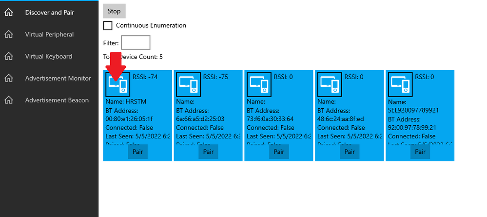

In order to connect your board to your PC via BLE with Bluetooth LE Explorer, you should click on device picture, see the red arrow on the following image:
I tried with BLE_HeartRate application and there is no disconnection. If you click on "Pair" button, the PC connect to the board and request pairing but if your board doesn't require secure connection the device rejects the request and a disconnection happens. In your screenshot "BT 4.2 Secure Connection:" field is equal to True, so I think you have click on "Pair" button.
