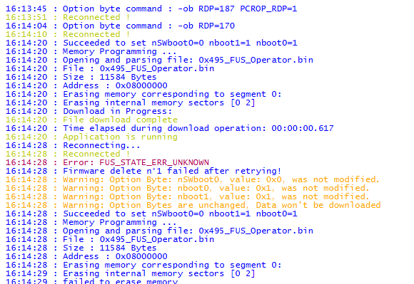

I have my STM32WB55RGV6 connected to my computer through USB using the ST-LINK port on the board. When trying to flash the coprocessor to run an example application from the WB firmware package, I cannot even erase the previous firmware.
Using the commands from the attached link results in an error to erase the firmware, with message FUS_STATE_ERR_UNKNOWN. I have no problems flashing the main processor with binaries using this tool or armKEIL, but for some reason I cannot get the hang of this. I have even tried following the release notes addresses for programming but nothing seemed to work.
Does anybody have a solution for this issue?
Thank you for your attention, I have added some screenshots below to make my issue easier to understand.
1- Initial Connection using st-link
2- attempting to erase firmware
3- attempting to flash FUS firmware
4 and 5 - Attempting to flash BLE full stack firmware

SFSA = 0xd4 => What kind of SW did you try to download???
Can you show me the list of commands you are using?
First you should start with a fwdelete commande. Then check that the SFSA = 0xF4.
At that point we are back to a known situation.

I'm just trying to flash the BloodPressure example.
unfortunately when i try to delete the firmware i get the error FUS_STATE_ERR_UNKNOWN so i can never get back to that good starting point

I placed the board into DFU for USB connection and seen the port USB1 available for connection. However Its complaining about Read Out Protection and wont connect even tho in SWD i confirmed RDP Byte is set to AA.
2020-08-19 4:24 AM
In fact, just saw that the ESE option byte is not checked. So no FUS is available on that chip as it is a non-secure chip.
Therefore, no way to load any encrypted BLE stack as no FUS is there to encrypt it and install it properly.
At the opposite, you can use it to load your own BLE stack on the M0+ or any other stack but you won’t get any support with this configuration as it is not the standard one.
