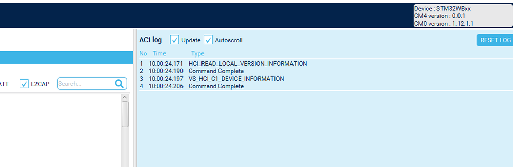

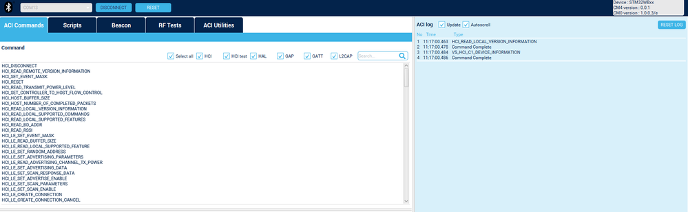

Once i flash the USB DONGLE (STM32WB55CGU6) with the
\STM32Cube\Repository\STM32Cube_FW_WB_V1.12.1\Projects\P-NUCLEO-WB55.USBDongle\Applications\BLE\BLE_TransparentModeVCPI am succesfully able to use STM32CUBEMONITOR-RF

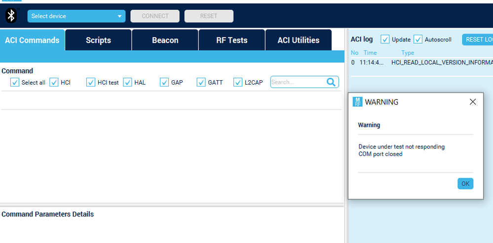

But when im trying to use the NUCLEO BOARD (STM32WB55RGV6)....
I flash the
\STM32Cube\Repository\STM32Cube_FW_WB_V1.12.1\Projects\P-NUCLEO-WB55.Nucleo\Applications\BLE\BLE_TransparentMode\Binary\BLE_TransparentMode_reference.hexAnd no response whatsoever, it doesnt work....
I am clueless why, maybe im flashing the wrong firmware in the nucleo board?
Maybe the coprocessor .bin is corrupted?
2021-09-08 8:32 AM
i believe this is caused because i corrupted the coprocessor firmware in both my nucleo boards, and i am unnable to programm it back to normal now
edit:
okay i put the coprocessor firmware back in place, now it works.
(trough stlink's usb not user usb)
