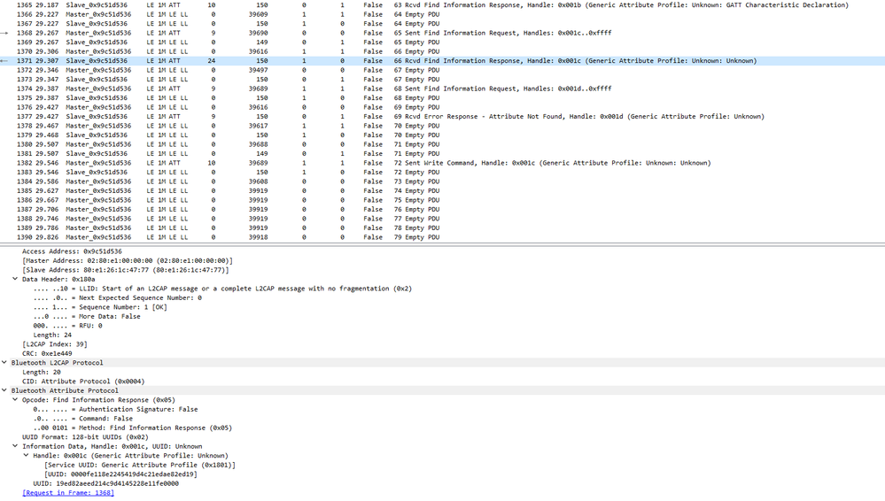

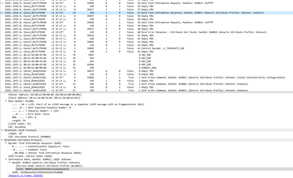

I have a BLE sniffer and I can see where the problem occurs but I have not been able to figure out what is causing it.
Here's a snippet from the Nucleo board that works:
Here's the snippet form our device that doesn't:
The LL_TERMINATE_IND is missing from our connection but I am not sure what is causing the problem.
