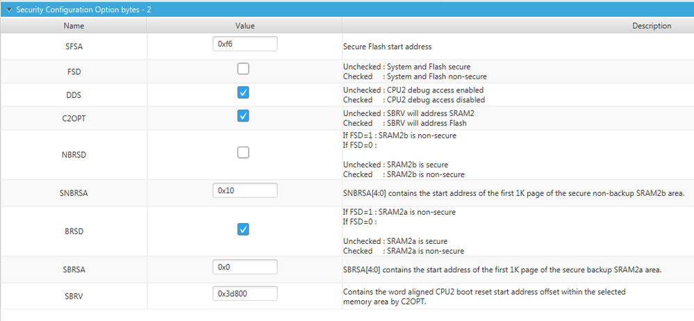

I have seen previous posters have errors with having no secured section on their board, but the ESE option byte is enabled, as shown here:

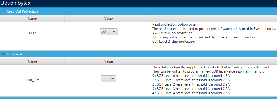

What are the options bytes?

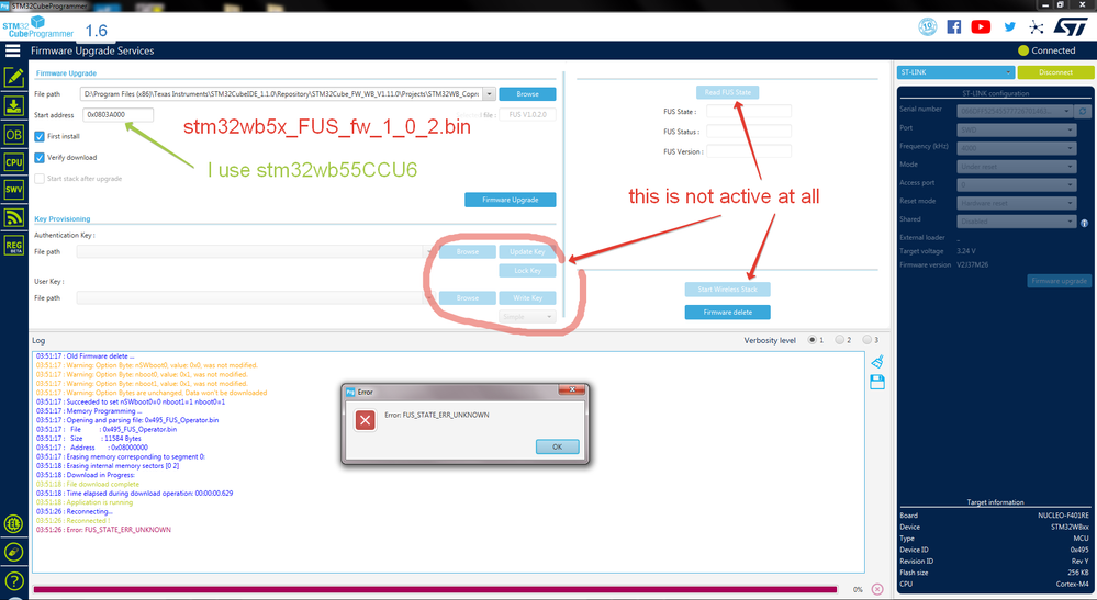

I want to run FUS on my stm32wb55CCU6. I just can't to know it's version!
03:52:30 : Old Firmware delete ...
03:52:30 : Warning: Option Byte: nSWboot0, value: 0x0, was not modified.
03:52:30 : Warning: Option Byte: nboot0, value: 0x1, was not modified.
03:52:30 : Warning: Option Byte: nboot1, value: 0x1, was not modified.
03:52:30 : Warning: Option Bytes are unchanged, Data won't be downloaded
03:52:30 : Succeeded to set nSWboot0=0 nboot1=1 nboot0=1
03:52:30 : Memory Programming ...
03:52:30 : Opening and parsing file: 0x495_FUS_Operator.bin
03:52:30 : File : 0x495_FUS_Operator.bin
03:52:30 : Size : 11584 Bytes
03:52:30 : Address : 0x08000000
03:52:30 : Erasing memory corresponding to segment 0:
03:52:30 : Erasing internal memory sectors [0 2]
03:52:30 : Download in Progress:
03:52:30 : File download complete
03:52:30 : Time elapsed during download operation: 00:00:00.632
03:52:31 : Application is running
03:52:39 : Reconnecting...
03:52:39 : Reconnected !
03:52:39 : Error: FUS_STATE_ERR_UNKNOWN

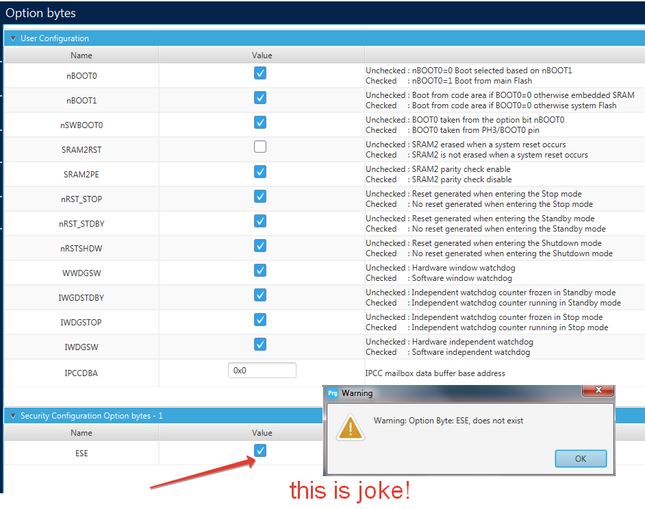

And also my Windows 7 doesn't see my stm32wb55CCu6 via USB. Windows says "there is unknow device" when I plug USB.
2021-03-11 8:39 AM
Excellent joke!!
Via USB you should be able to see the version of the FUS either reading the value at address 0x20030030 or via the Cube Programmer tool using the “read FUS state�? function which is greyed when connected via SWD as it is not supported via this interface.
