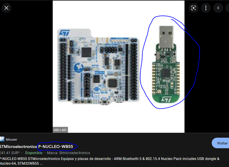

2022-05-05 3:59 AM
You could use USB communication from a BLE dongle
BLE is not meant to be Fast, and its not easy to develop (at least it wasnt for me)
Why do you want to use BLE and not just USB
2022-05-05 6:37 AM
I'm developing an implantable biosensor with a microcontroller. So, all the wired system is not my option.
2022-05-05 6:38 AM
Should I program USB dongle also?
2022-05-05 6:51 AM
Because somebody sells a BLE wireless camera, the BLE should be enough to send to a PC with 30 fps.
2022-05-05 6:53 AM
Only youre unable to use BLE with your PC Labview, use a dongle as a USB<->BLE bridge. (yes you would need to programm it)
