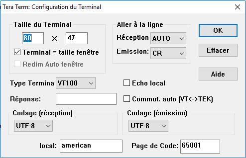

2019-08-22 2:32 AM
Here is the configuration for Tera Term VT terminal:
After a reset of the Client board and a switch off the blue LED you should see on each terminal window the following screen:
On each terminal, written characters are sent after each hit of the "enter" key.
Best regards.
