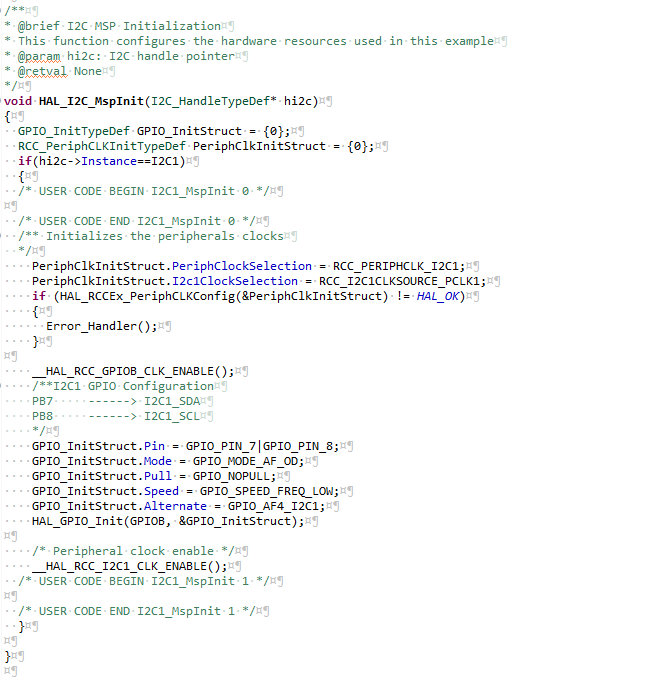

I'm trying to connect an OLED display to my STM32WL55JC by I2C but it doesn't work...

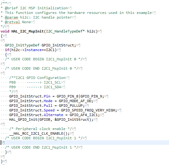

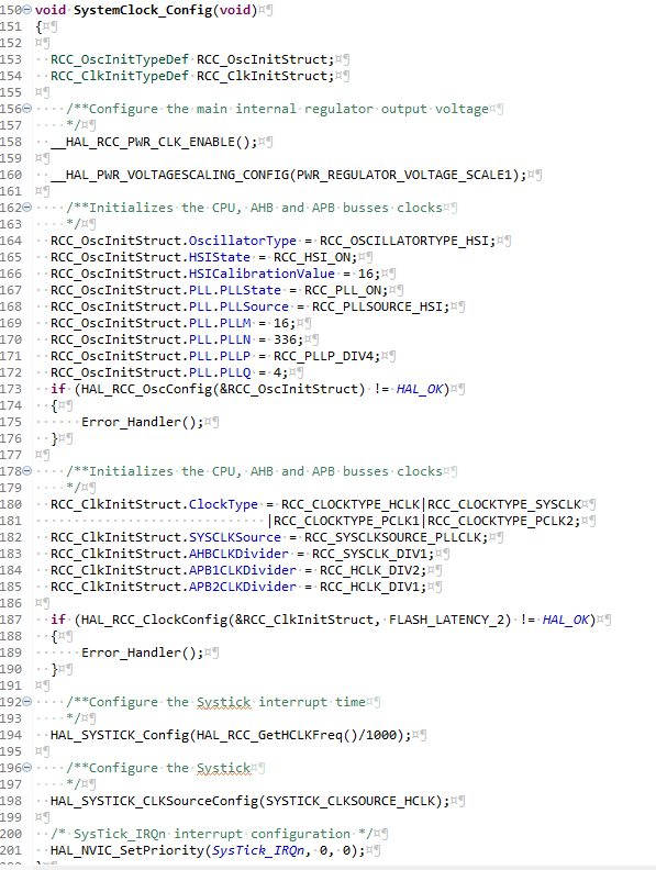

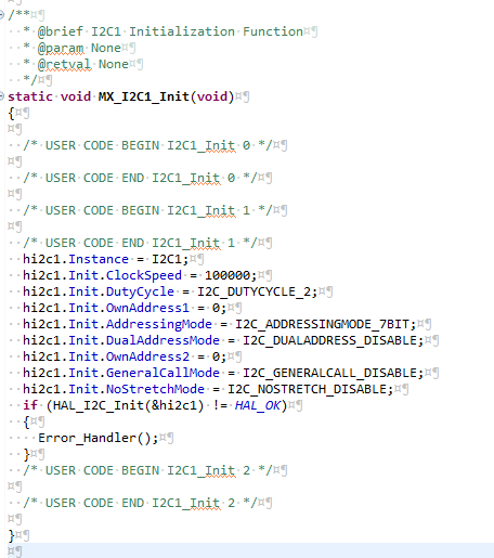

I've successfully connect it with a STM32F411RE but the I2C configuration / HAL interface seams to be different between both MCU...
Here my config on the STM32F4

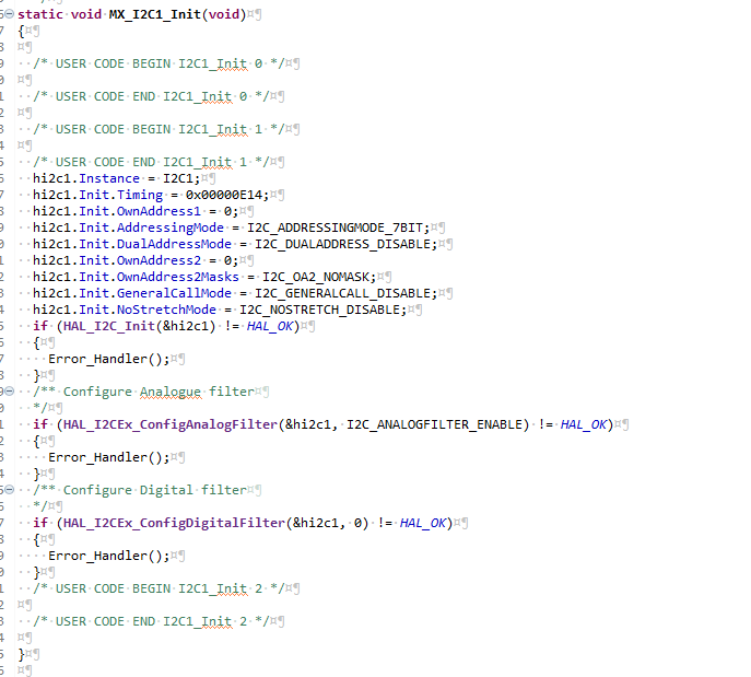

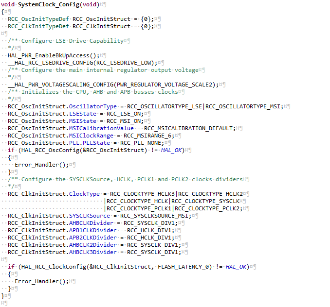

Here my config on th STM32WL :
Does anyone know whats wrong ?
Thanks so much !
Hugo P.

2022-05-12 2:11 AM
Thanks a lot, I think that was an hardware mistake... My bad... Now its all solve !
