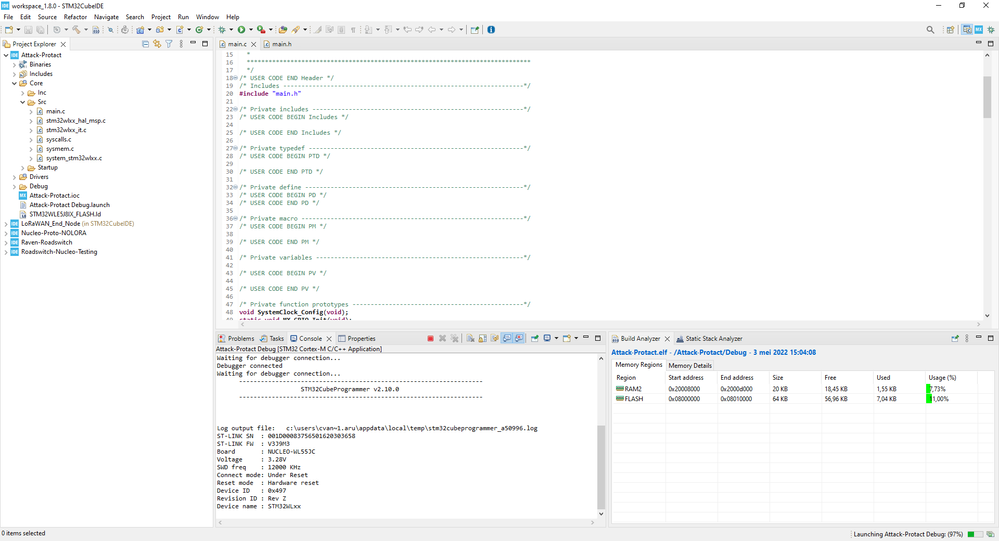

Hi all. I've got a problem when trying to flash the STM32WLE5J8I6.
I am trying to run a simple blinky code and blink an onboard LED on my custom pcb.
The program builds fine, connecting with the ST-Link (Nucleo-WL55JC1) and using SWD to connect to the STM32WLE5 works. However, when running or debugging, the program gets stuck at 97%. See picture.
The following output is seen in the console:

2022-05-10 1:51 AM
Hello @Cvan .7 ,
Do you have CubeProgrammer stand alone? If so, do you experience a problem with it?
If you look in C:\ST\STM32CubeIDE_1.8.0\STM32CubeIDE\plugins\com.st.stm32cube.ide.mcu.externaltools.cubeprogrammer.win32_2.0.200.202202231230\tools\bin\STM32_Programmer_CLI.exe directory, is the CLI.exe placed here ?
Best regards
Louis
2022-05-10 2:05 AM
Hi Louis,
First off, thanks for your help.
The ...CLI.exe is placed there.
2022-05-12 2:49 AM
Hello @Cvan .7 ,
Have you the same behavior with CubeProgrammer in stand alone ?
Regards
