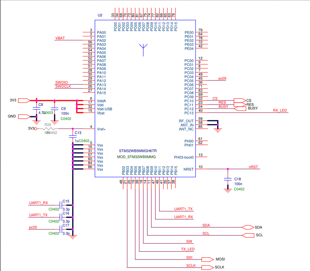

I am having a problem with STOP2 mode on the STM32WB module.
Based on recommendation given in AN5506, I took the Zigbee_OnOff_Client_SED project and flashed it into the custom board hosting the STM32WB5MMGH6TR module (there is nothing else on the board, just the module). The board/module are powered from 3.3VDC.
My problem is too high current consumption. I expected to get few uAmps but I got hundreds uAmps.
When I connect the SED to the Zigbee_OnOff_Server_Coord I get 168uAmp, instead of 3uAmp (defined in AN5506) in a sleep mode.
At the same time if I connect the SED to another ZigBee hub (*****) as a general ZigBee device I get 3mAmp!!! So the SED never sleeps.
To make sure the measurements are done correctly I disconnected the ST-Link.
The symbol STM32WB55xx in the project is redefined to STM32WB5Mxx.
I also tried the example "PWR_STOP2_RTC" but it doesn't work.
So there two questions:
1) Is it really possible to get down to 3uAmp? What shall I do? Is there any instruction? I have tried everything I could.
2) Why there is a difference in the current consumption when connection to different ZigBee hubs (Zigbee_OnOff_Server_Coord vs *****)? Is there anything specific about SED in the hub? It looks like the SED never sleeps when connected to one hub and it sleeps when connected to the Zigbee_OnOff_Server_Coord.
Thank you for your support!

I guess ST has provided the schematic of the nucleo board as well as the packaged used (being STM32WBRG = 64 pins)
and the module STM32WB55M-CSP100 or STM32WB55M-QFN68 : here, I am not sure... can you add the schematic in the ticket and WB exact package?
